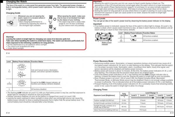

Hey can I charge the watch for hours under direct sunlight? I just kept it under the sun for an hour and the battery meter went from M to H, but the watch got fairly warm which is kinda scary.
As per the manual watch getting hot is normal.
Sounds like you need to reset your module. Follow the instructions I posted earlier and you should be good.

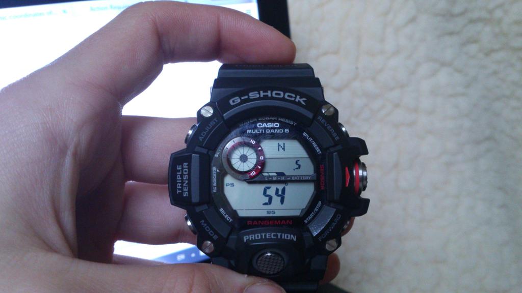

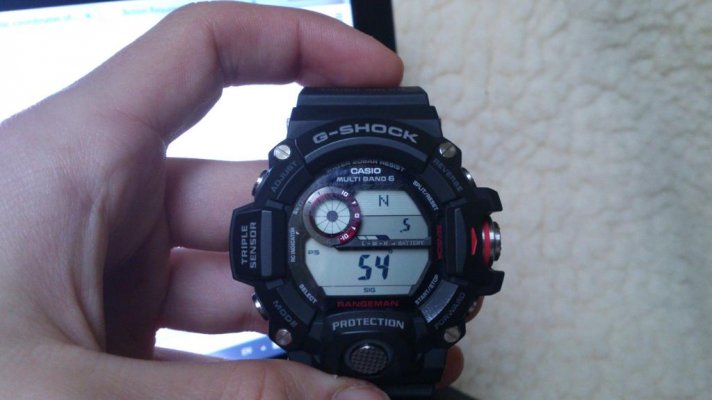

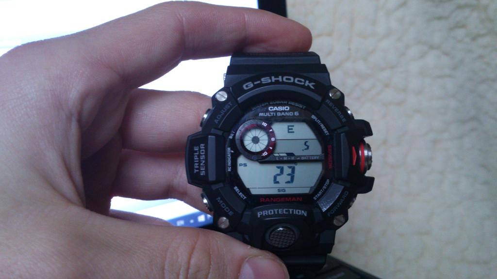

Hello fellows,
I found this forum extremely helpful, but I still have problem with my Rangeman altimeter.
I live in Kaunas, Lithuania. Coordinates Latitude: 54°54′ N; Longitude: 23°54′ E (http://dateandtime.info/citycoordinates.php?id=598316); Elevation above sea level in a place where I live: 73 m.
The problem is that altimeter always shows different results. I calibrate it, leave for few hours and check altimeter - it is totally wrong.

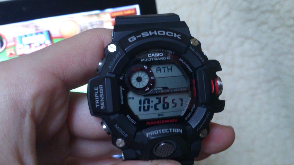

Yesterday about 22h I reset the module again, set the city (Athens), coordinates, barometer (yesterday air pressure was 1026 hPa), elevation (73 m.)

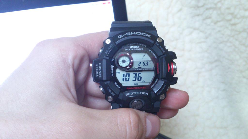

Today I've checked data - now air pressure is 1036 hPa (http://www.foreca.com/Lithuania/Kaunas), which is correct on watch.

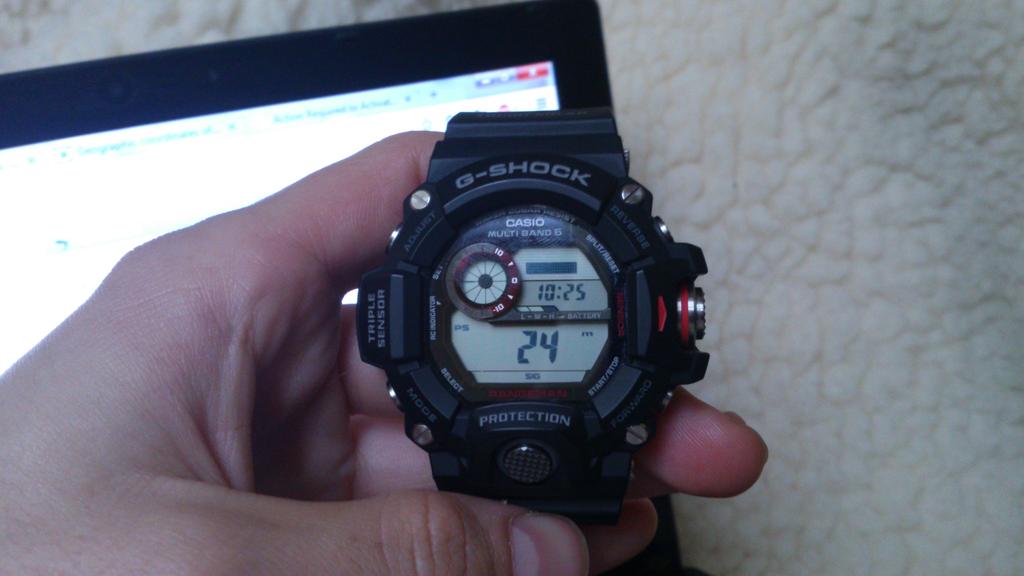

But altimeter is still completely wrong. Now altimeter shows 24 m, instead of 73 m.
Altimeter is one of the main functions why I've bought this G-Shock, so it is quite frustrating when you cannot rely on it. Especially when I go to military, I am never sure that altimeter shows correct data (actually, it never does).
No error is shown, on reset module every symbol is visible, so I assume sensor is not broken.
Do you have any advise on this?
