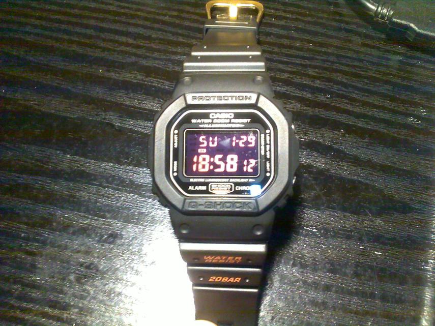

The watch is amazing, it actually looks even better than I expected. Really really like the way the colours go together - black, silver text, reddish (display) and a little yellow "arrow". Love it :).

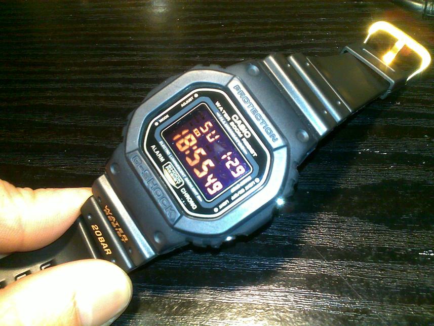

Obviously and unfortunately I have already spotted an imperfection. An arrow-shaped "shadow" in the upper center of the screen. It is visible at a certain angle in a certain light. Visible in the pictures below. Do you think it could be steam? It would not be good at all because it would mean it's not waterproof. Do you think it's easy to wipe off once I open the watch? I've never opened a g-shock before, actually. I didn't get the receipt or warranty for the watch, either. I think I could still return it, but I don't want to!
Watch looks good, glad you're (mostly) happy.
Not sure on that mark at all. Have had a couple with condensation problems (one from new!), however the condensation has only shown when the watch has gone from a warm to very cold environment and has appeared as obvious moisture right in the middle of the glass. As soon as the watch goes back to a warm place (i.e. indoors) the condensation soon disappeared. As such I'd probably discount condensation i nthis case.
Hard to know what to advise without having the watch to look at. If you aren't happy with the mark to the display (and why should you be) I'd think about returning it. Certainly the seller should take any risk when it comes to opening the case etc.

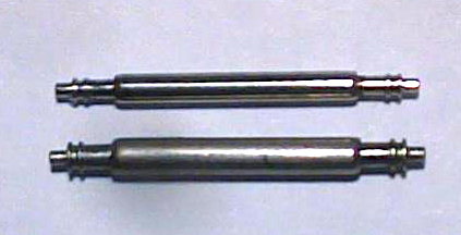

Well, there actually was another unpleasant surprise for me to be discovered. It's shown in the picture below. And this one will be reported to the seller. Am I thinking correctly? Is the smaller pin a not-g-shock pin?
