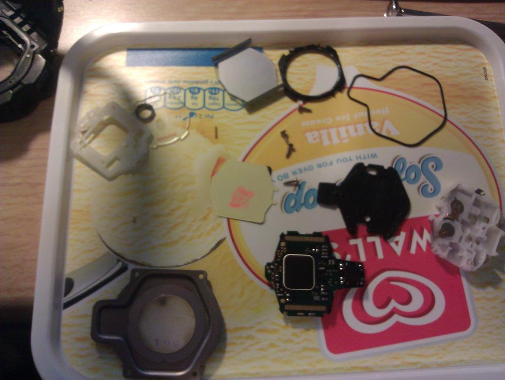

Came apart easily enough. Interestingly slightly different construction to other Gs I've taken apart. Normally the module sits in a rubber mount (which supposedly gives the shock resistance) and is decopuled from the case. Not here, the white battery section (bottom right in pic below) is clipped into the case. Once this is removed the whole lot falls out!

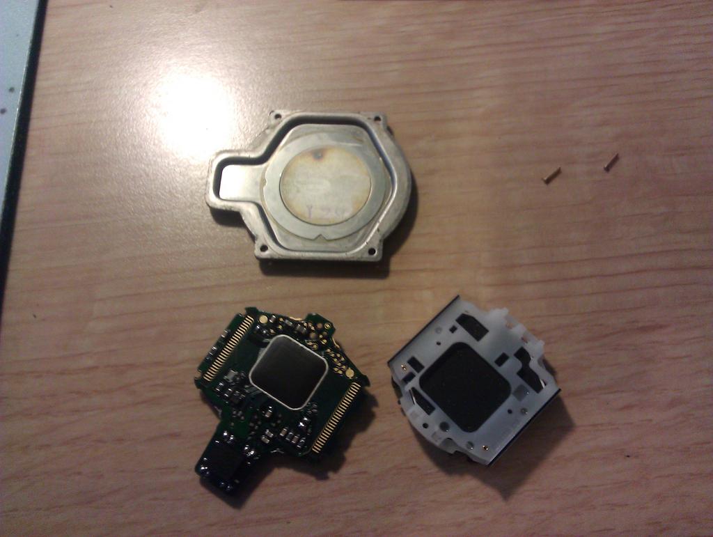

Took it down to constituent parts. Cleaned with switch cleaner which is about the strongest stuff I have. Never 100% sure if it's a good idea using this on something as delicate as a module but I've never had issue with it in the past...
Reassembled is easily enough. First time it went back together worked first time. Hooray! Took the battery section off again to replace the alarm springs. Nothing. Doh. Then having taken a closer look at the module I realised I was using the wrong hole in the rear of the module for AC Got the right AC, module started up, all back together and working nicely. Phew. Display seems a little better than before but does seem to dim a little on occasion.
