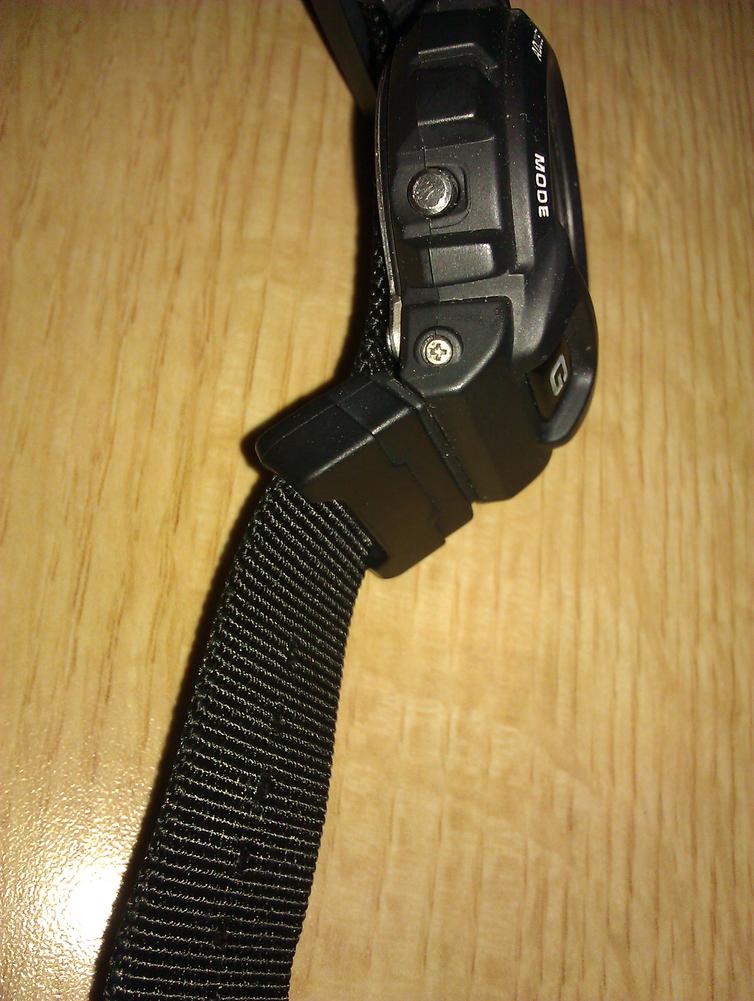

Anyhow fitting is quite simple.
1. Remove the spring bars and existing strap.
2. Fit the strap adapters using spring bars. From memory I had to adjust the adapters slightly with a craft knife to ensure a good fit.
3. Loop the band through adapters.
4. Job done!

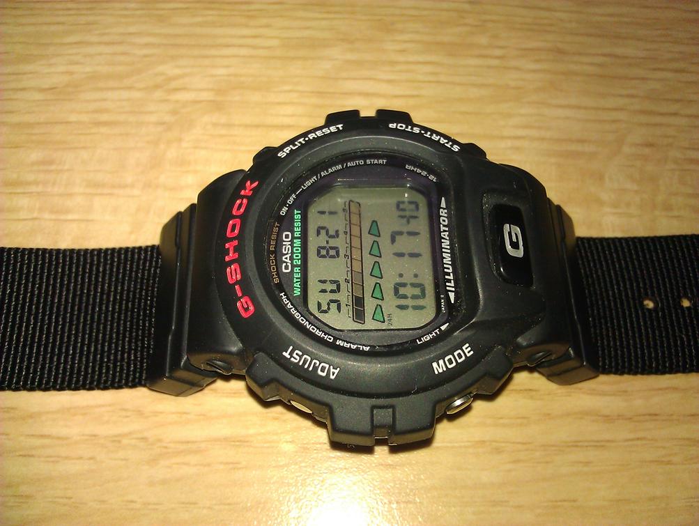

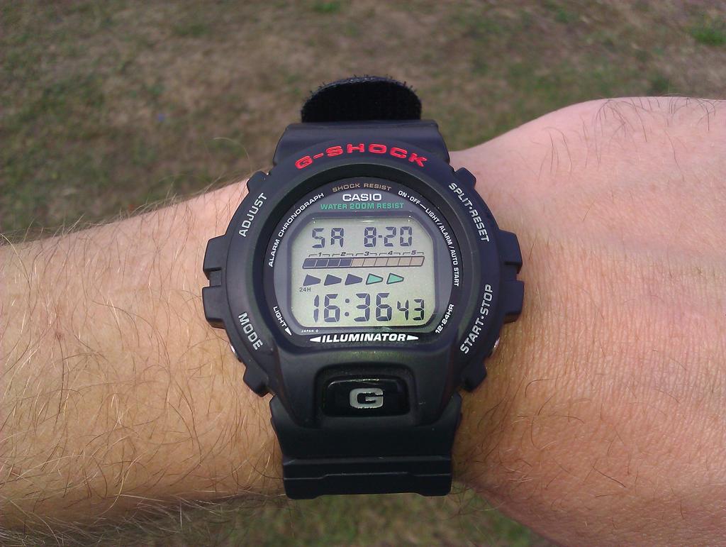

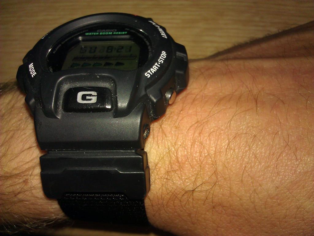

The G-Shock's look good on the fabric straps imho, the approach I've taken here (which many have done before) looks really clean and stock imho. Pics below.
